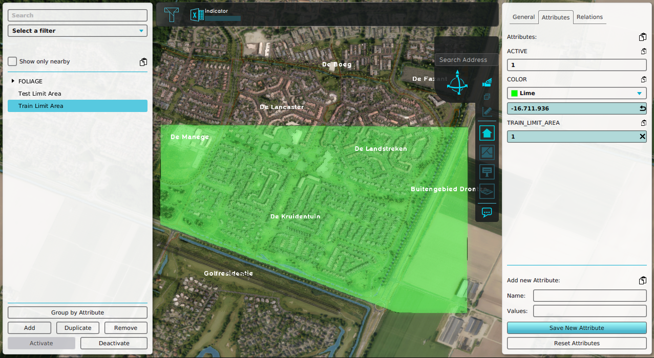

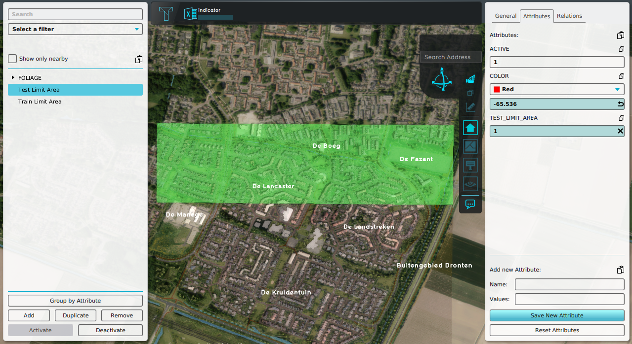

Demo Train Dataset is a project that contains shapes of foliage, drawn as areas on top of a Satellite Overlay. These areas, in combination with satellite images, can be exported as a dataset for training a Mask R-CNN model. Such a model can then be applied to a different project location to detect foliage. A specific use-case is detecting foliage on private property, such as gardens and private yards. Each area is assigned the attribute FOLIAGE. The project also contains two large areas, named Test Limit area and Train limit Area, each with a unique TEST_LIMIT_AREA or TRAIN_LIMIT_AREA Attribute. These areas will be used to split the Foliage areas into a group of test and train data.

Train limit area used for exporting a Train Dataset.
Test limit area used for exporting a Test Dataset.

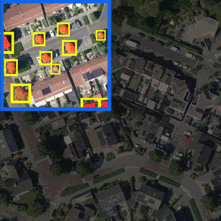

- Optional: A text file containing the bounding-box pixel numbers; min x, min y, max x, max y, for each identifiable feature in the input image.
Input image, in this case an image exported using the Satellite Overlay
Mask image with each unique feature identified by a gray value.
Class labels
Bounding box coordinates

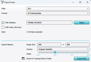

- Select Current Situation in the ribbon bar
- Hover over Areas, and select Export Geo Data
- Under Format, select the option AI Training Data PNG
- Select the With Attribute option, and select the following attribute FOLIAGE
- Select the Intersecting Areas option, and select the following attribute TRAIN_LIMIT_AREA
- For the Overlay option, select the Satellite Overlay named Original Satellite.
- Set the image size to 200 by 200. This ensures that the amount of areas per exported image does not exceed the maximum of 250.
- The stride can be kept at 50%
- Click on the Export Files button
- Select a suitable folder for the generated dataset. For example: user/documents/foliage/train/demo_training_data
- Wait until the dataset is fully generated.
To export a test dataset, replace the intersecting areas attribute TRAIN_LIMIT_AREA by TEST_LIMIT_FOLIAGE and export it to a different directory, for example user/documents/foliage/test/demo_training_data

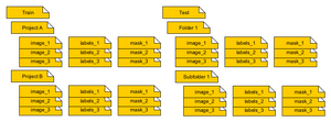

- The train sets can obtain data files from sub-folders. For example, if data was exported to user/documents/foliage/train/demo_training_data, the PATH_TO_TRAINING_DATA can be user/documents/foliage/train/. This makes it easier to train on data exported from multiple projects and combining it with your own custom data.
