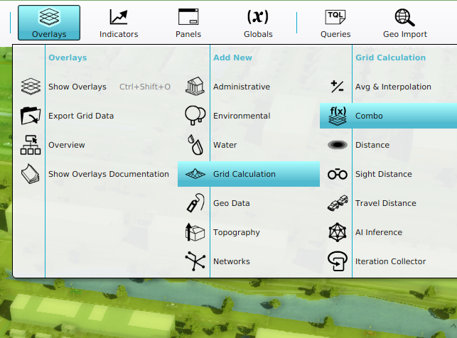

- Add a Digital Terrain Model Overlay to your project.
- Add an Average Overlay that selects a specified attribute. This can be a custom attribute or a more general one, such as NWB_ID.
- Add a Combo Overlay with the Height Map Overlay as input A, the Avg Overlay as input B, and with the formula: IF(GT(B, 0), SUB(A, 0.2), A).
- This Combo Overlay displays a height map with all roads 20 cm lower, and all other areas as they were.
- Go to Current Situation → Terrain → Select Elevation Grid Overlay
- Select the Combo Overlay and confirm the operation.
