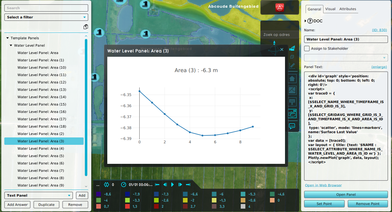

Information of the linked item, such as a name or average grid values, can be obtained using TQL statements with ID clauses.
For example a Template Panel can be configured for Areas with the attribute Water Level to create Panels linked to a Water Level Areas and are placed at their center points.
